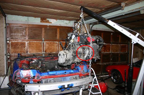

Very nice! but I can't see the turbos? I must be blind.
Keep up the good work doc!

Front:
Rear:

no ur not blind they jsut tooo small...lols... took me a while to find it while i was there.. lOZLl
nice job doc...is the other smic still there?? i only see one

Am I going to have to circle it for you too!?!? LOL
If you look carefully, it's leaning against the other one.
