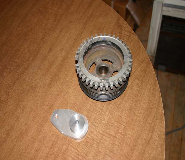

Well it's been a while since I've been busy with other projects, but this past week I had some time to work on this while waiting for parts. Here is the distributor block-off plate and the trigger wheel mounted on the crank pulley, balanced within the weight of a mosquito's eyeball:
The block-off plate installed:
And the crank pulley and VR sensor installed:
-Doc

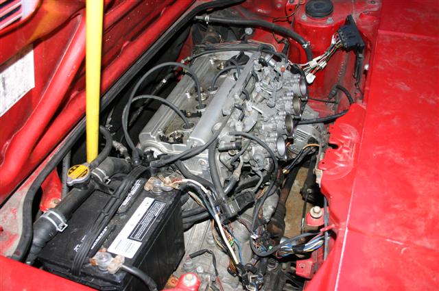

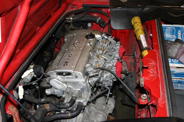

Updates!
The whole intake manifold/ITBs removed for examination:
All the parts:
Everything installed:
Making the harness out of MR2, Silvertop, MS, and EDIS wiring!
Cooling system done and all the mechanicals ready to go:
Should have the ECU and the engine talking by sometime this weekend
-Doc

Holy crap! That thing looks sick in there!!!
And by talking... I take it you mean running....?

No, by talking I mean calibrating sensors and that kind of thing, but once all that's squared away, it could be pretty close to it's first startup
