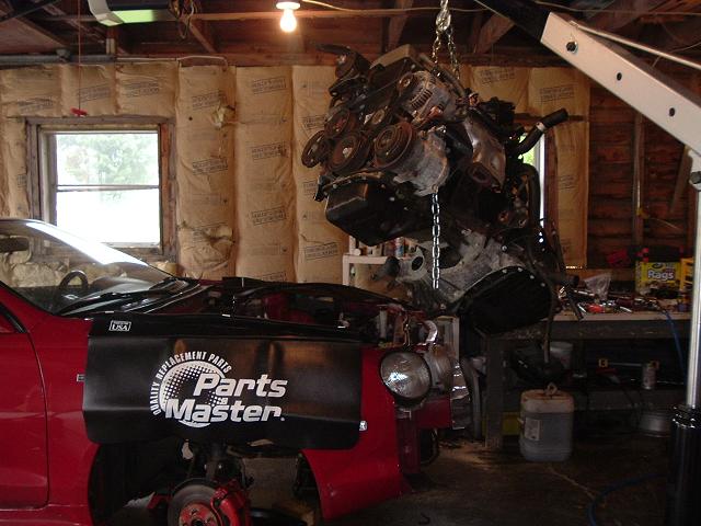

I just came in for lunch and thought I'd post some pics of my progress
The cleaned up turbo and newly machined flywheel:
The extraction:
Pull complete:

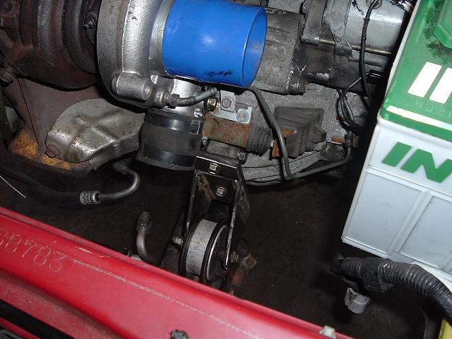

Turbo, clocked and assembled:
Starting work at the wiring station:

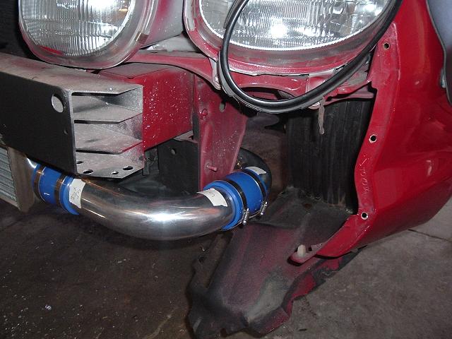

This is the custom front motor mount that I built since we didn't get the right part that we needed:
Mocking up the intercooler:
How the intercooler is installed:
Intercooler piping done on one side:
Front view:

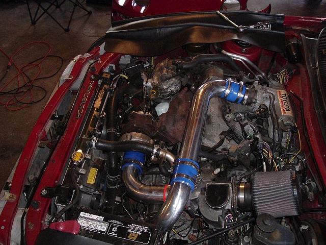

So I've completed the car pretty much, except for a few items that have come up. First off, the engine coolant sensor (for the guage) isn't working, and I don't want to run the engine without knowing the temp (the engine runs great though). I got the exhaust all taken care of, but the power steering system is acting up so I need to fix that up (just bleed it out and whatnot most likely). The major issue at this point is the clutch is making a lot of noise when engaged, so I dropped the tranny today and I'll check it out further on Monday.
Here are some pics of the completed intake and intercooler piping system:
