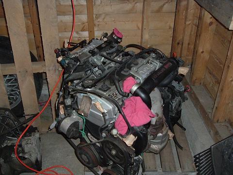

Starting tomorrow is Alex's 4EFTE Tercel swap. The car is a '94 with the 3EE engine, 1.5 liter making like 80hp or something like that.
The engine is a 4EFTE from the Japanese Toyota Starlet GT. It is a 1.3 Turbocharged engine making 135hp and 115ft/lbs. It is quite east to upgrade this engine and get it near the 200hp mark.

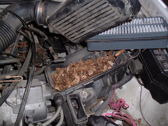

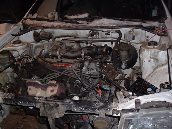

When we got this car, the engine wasn't running right. In fact, it would barely run for me at all.
Gee, I wonder why:
Packed FULL! It's a wonder the engine could get any air!

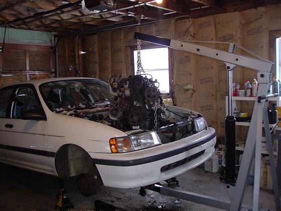

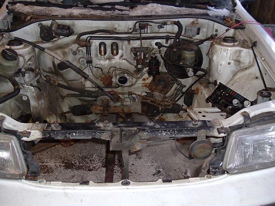

So the reason that the engine didn't come out yesterday is because the speedometer cable was rusted and wouldn't come off. I worked on it this morning and got it loose. Then I pulled the engine. It's a tight squeeze through that Tercel engine bay!
Landed:
Empty engine bay:

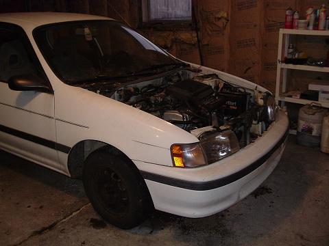

4EFTE installed:

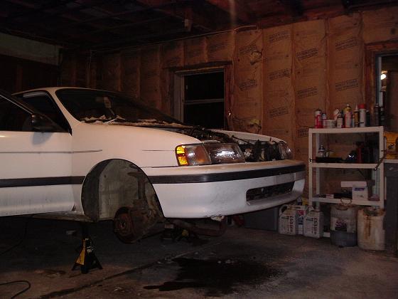

Today I put in about 5 hours and I got the engine all hooked up. The engine is cranking but not starting, it's a wiring issue that I will sort out on Wednesday.
I also filled the engine (obviously), primed it, filled the tranny, and installed the axles. The car is back on it's wheels now.

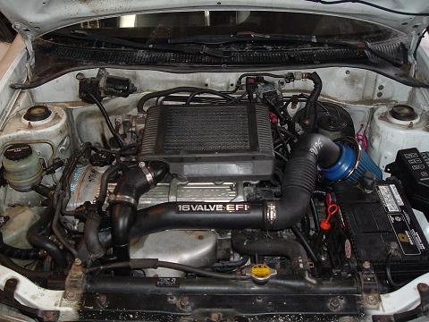

Install is done, wiring is done and loomed. I need to install the grill, take a peice of the hood support out (for the intercooler), and put the interior back together. And install an O/D switch.
Oh and get the exhaust done.
