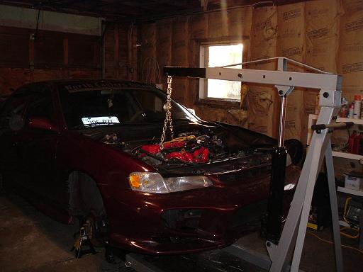

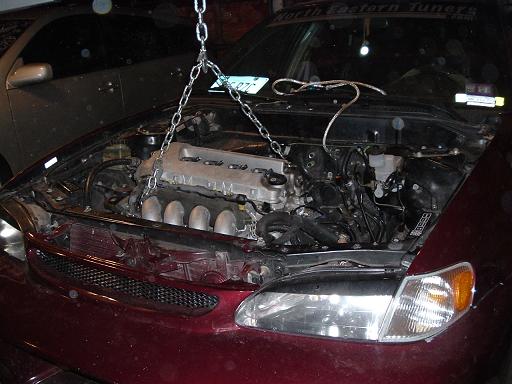

Okay Jerry, as promised, your updates and pics. I put 9 1/2 hours in today, from walking out to the garage and figuring out what to do, to walking in the door a couple of minutes ago. Your 1ZZFE now sits on my garage floor. I disconnected all of the wiring, lines, etc to the engine, pulled the axles, and then pulled the engine. I pulled the interior apart to get to the ECU, which was under the storage area right in front of the shifter.
The whole operation of disconnecting everything went VERY well. I was suprised at how hard the rest of it was. The act of actually pulling the engine out was quite difficult. The rear mount kept getting caught under the steering rack, it was driving me crazy! Haha
Also, I pulled the power steering pump and ac compressor off without disconnecting the lines, so the system was never opened. I will install them onto the 2ZZ which appears to have the same setup.

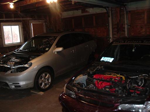

The two cars together, intact for the last time:

Everything disconnected from the engine, almost ready to go:

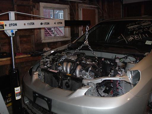

Set up to pull (Jerry, this hoist is awesome
Halfway out:
Finally hanging free:

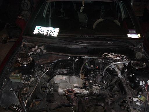

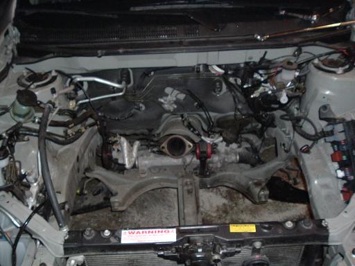

What the engine bay looks like now:

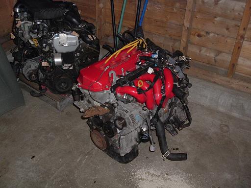

Anybody want a nice 1ZZFE? I happen to know that the guy who pulled it did a great job!
The parts pile:

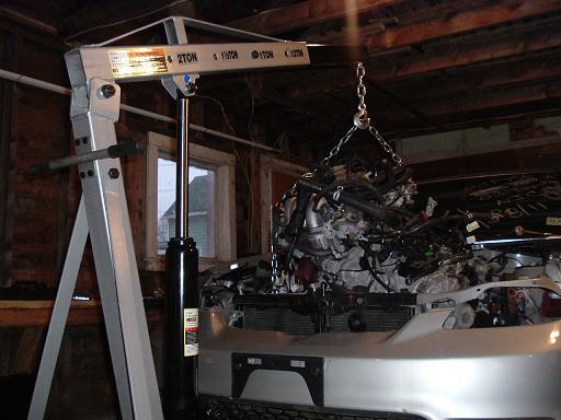

Anyway.... I put another day in today and things went as planned. I had some trouble seperating the passenger side driveshaft, it was rusted badly to the bracket. You couldn't even tell it was two peices. Odd, for a NJ car that's only a couple years old. I'm sure that it hasn't been taken apart up till today.
Other than that, the pull went well, easier than the 1ZZ in fact thanks to the location of the steering rack. In the Matrix it is located below the rear mount, so there was no interference. I also knew which mounts to remove first this time.

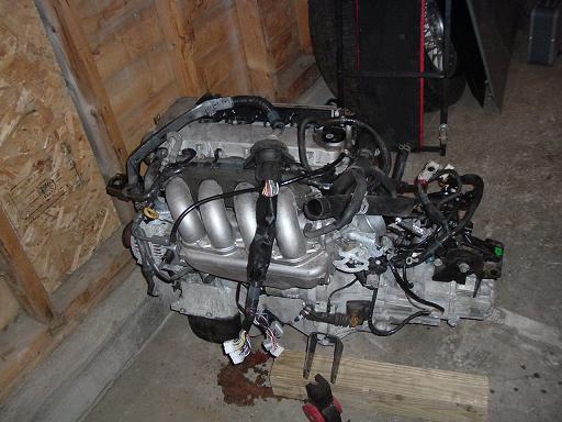

Here is the 2ZZ with everything unplugged, harness on top:
Getting it free of the mounts:
Swinging in the air:
Another safe landing:

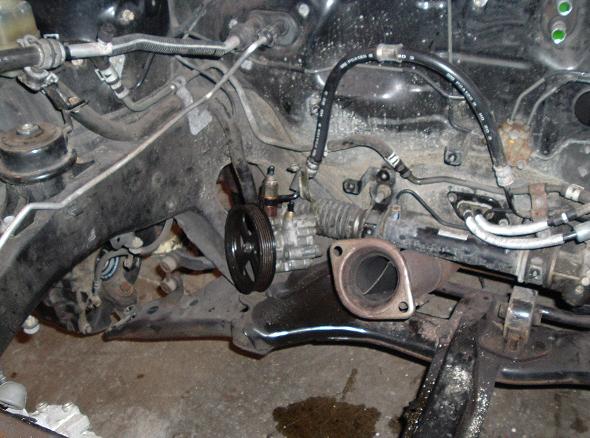

And the now empty Matrix engine bay:
Do you Matrix owners have any tips to getting at the tensioner bolt? There was no room at ALL to get to it. I could get a wrench on it but whoever tightened it last must have gone nuts on it, and I couldn't get it off with my wrench (I didn't want to round off the head). I had to undo two of the motor mounts and pull the engine up enough to get my breaker bar and 6 point socket on it. What a pain! In case you're wondering, I'm going to use the power steering pump and ac unit from the 1ZZ as I left the systems intact, that's why I needed to get at the tensioner. I noticed that the pulley on the power steering from the 2ZZ is bigger though, likely due to the higher rev limit (So as to not spin the pump too fast). So probably I'll put that pulley on, though I'm sure Jerry will want some aftermarket ones soon enough.

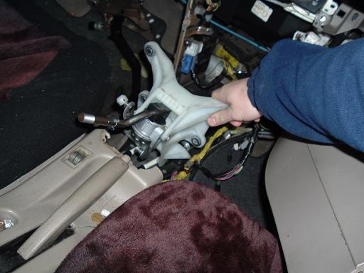

I was worried about the length of the shifter cables, especially when I pulled the '98s and saw how much longer it was than the Matrix'. Then I remembered that the linkage is on the other side of the transmission. :lol: They have enough length so that I should be able to mount the shifter in a mostly stock location. Here are the new 6-speed cables coming out of the firewall:
And here is the approximate place that the shifter will be, after some modifications. It should be in the original '98 position, but sit a little higher. It will need a custom made bracket. I'll have to make it extra strong, I can just imagine Jerry yanking on that 6-speed!

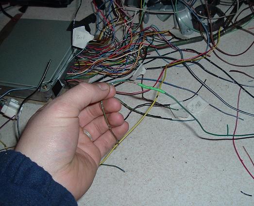

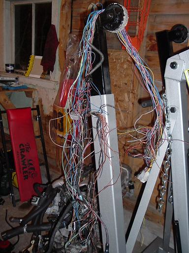

The entire 1ZZ engine related wires have been pulled from the harness, now I need to straighten everything out, and then lay them side by side. The 2ZZ harness has so few body related wires that I'm not going to waste time tearing it apart, I'll have the wires right inside the car if I need them for whatever reason.
I need the 1ZZ wiring diagrams before I can go any further with this anyway. I know exactly what needs to be done in my head, but without knowing which wire goes where it has to wait. Jerry, you said that is in the mail? It's not a big deal even if it's late, I still have the engine mounts to work on, exhaust, etc etc.

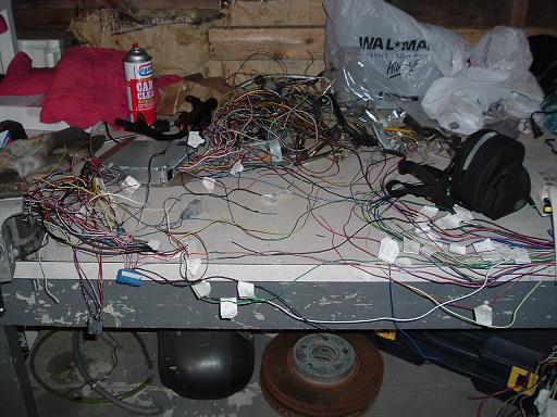

Anyway, wiring harnesses suck. Once I get that manual with the diagrams that will make things easier, but one thing's for sure. This is going to take a while. :mad:
Let's see what I got for you guys tonight. Here's the 1ZZ harness with pretty much all the engine related stuff pulled out. There's still some work to be done but once I have the manual I'll be able to finish it up. The 2ZZ harness I have stripped of all the shielding, but I haven't started to seperate the harness yet.

Well I just got in from spending several hours out in the garage, and I'm happy to report that I made excellent progress on the wiring harness. I went through and labelled the entire 2ZZ harness, and started on labelling the Rolla's body harness. If I can put one full day into it (Tuesday) then I should be able to finish it up, though they're might be a few bugs to be worked out.
Here is the harness all labelled:

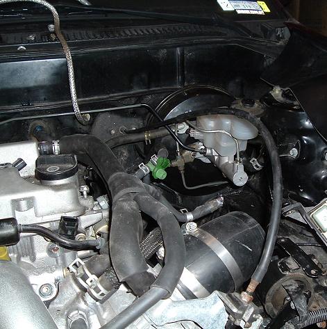

A new sight in the engine bay: Not only is there now a clutch master cylinder populating the engine bay, but the Matrix' brake master cylinder is also being used. Quite a bit of custom work needed. (A couple minor things to be finished up)
(Jerry, when he picks up his car) "Eh... what's this third pedal do?" :lol: How's it look?

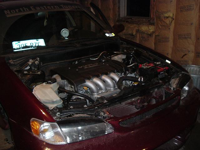

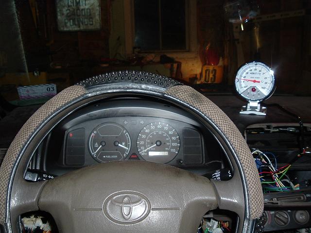

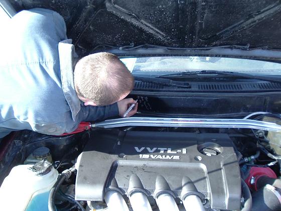

Here's a sneak peek of the 2ZZ in the Corolla. Don't get too excited, it's not in there yet.
After the last update I went back out and spent a few hours test fitting the 2ZZGE. It's going to take at least a full day to sort out the engine mounts. That's going to be my mission tomorrow, *hopefully* the engine will be in there by the end of the day.

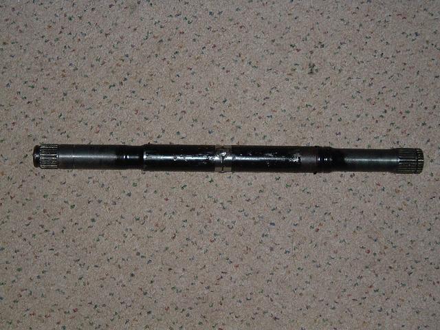

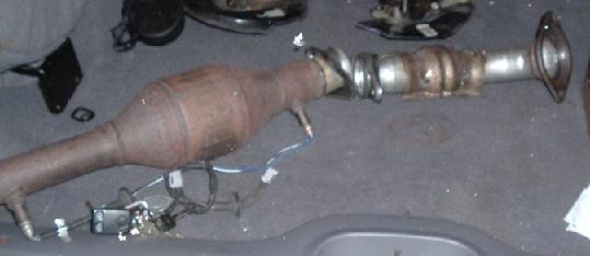

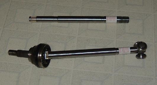

I also discovered that the axles will have to be custom, unlike my original understanding. I will be able to take care of that without too much trouble.
The exhaust manifold, on the other hand, is going to be a serious pain. I can't even bolt it to the engine because it hits the firewall. The manifold will have to be modified, along with the head pipe where it attaches.

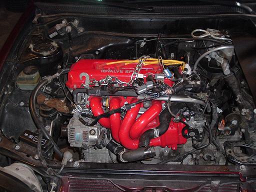

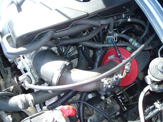

First of all, the exhaust manifold was modified. It's pretty rough right now though totally functional, once everything else is squared away more attention will be given towards looks and better flow.

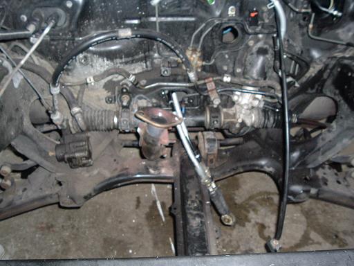

I had a frustrating series of days of driving back and forth between the machine shop and the pipe bending shop. Thankfully that's all taken care of now. Also, the stock '98 Corolla shifter assembly is not compatible here. A custom brake line and custom a/c hose were needed.
Custom head pipe and connectors:
Custom brake and clutch line:

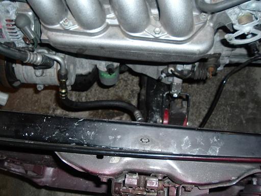

Custom a/c line:

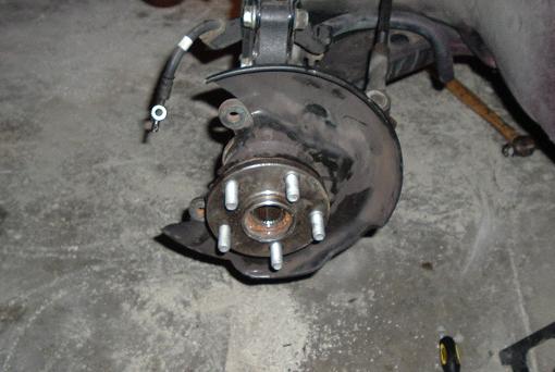

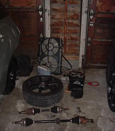

The 5-lug and big brakes were modified to fit onto the Corolla:
Hooking up the wiring harness:

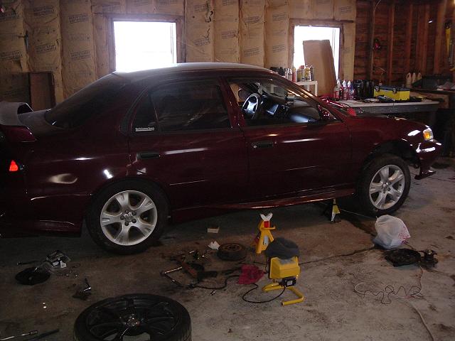

The 5-lug conversion completed and the Matrix wheels on the Corolla:
I bled the brake lines and clutch line out. The clutch is now 100% operational. The axles are going to need to be taken back out and modified further as they are too long.

Yesterday I put in 10 hours working on the wiring, and today I put in 11. At the end of the day I was able to start the car!!! I only ran the engine for a few seconds since the cooling system isn't hooked up yet.
I had most of the wiring done yesterday, today I ran the harness through the firewall, wired up the 02 sensors and a/c stuff, bypassed the start neutral switch, and a few other things. It didn't start right off, I had to fix up a couple wiring bugs first.
Once the car started, it ran rough for a couple seconds and then it died. I went through all of the vacuum lines and plugged or hooked them up. Then I went and started the car again and it ran really smooth. I shut it down a few seconds later.
Pictures coming soon

Want some pics?
Here's what it looked yesterday. You can see I stuck the TRD Matrix intake on there so that it would be breathing filtered air, and so that the MAF would be reading the air. No, it's not going to stay
Also you can see the custom upper radiator hose I made
Here's what the inside of the car looks like right now, this will all be loomed and cleaned up...
Here's the harness in the engine bay partially loomed:
And what I did today: this shaft has been cut in half and tack-welded together for a test fit. This is the correct length after I checked it on each side. It will be shipped to Moser Engineering so that two custom ones will be built just like you see here, and then the Rolla will be ROLLING!

I put in a solid day today, which is a good thing being that this thing is being raced on the 27th. There were several bugs I had to work out. First of all, the engine temp guage wasn't working. That took a while to work out and thankfully it's all done now. Also, the #1 Fan relay on the '98 is normally closed, but the one for the '03 is normally open, so I need to find a new relay to fix that... at least I figured out what the problem was. (The fan runs all the time when the key is on right now.)
I also filled up the cooling system and ran it for a good 20 mins or so, it got up to operating temp good and stayed right there. I loomed the rest of the harness up and that is pretty much done (unfortunetely, I did that before fixing the wiring bugs, so I have to redo a little bit of it), I just need to loom the wiring inside the car. I also tested an aftermarket tach and it works well, so I'll get that wired up next.
Some pics:
Here is the wiring all loomed up nice:
And the 99% finished product:
basically just need to fab an intake and finish the vaccum routing, and fix up the wiring that's left (very little), and the engine is done.
Then, when I get the axles, I just need to install them and the car will be road worthy, sorta. I just need to run to the exhaust shop and have the mid-pipe and muffler welded on and it's DONE.
A final item will be the rear disk/5-lug conversion, but that can wait until after the meet if need be. Hopefully, it will all be done.
And this car needs a bath!!!

Lots have been accomplished over the past few days and the entire job is within hours of completion.
First of all, I started putting the interior back together and wired up the tach... look, it's running!
The engine bay is 99% done, just needs an intake:
I got the Celica parts that I needed and started the rear disk/5-lug conversion. When I first compared the parts, I thought for a minute that they would bolt right on. I was getting excited that it would be a plug and play swap-over. However, that wasn't the case. I took a trip to the machine shop, took the wheel bearings and hubs apart, modified and rebuilt them, and then carefully put them back together with all new grease. The backing plate still needed to be modified some, but everything is now bolted up. This is a sneak peak of one side, the parking brake cable still needs to be shortened.
And what the car looks like with the Matrix wheels:
Lastly, I got the custom axle bars in today. After putting these together the front end should be pretty well taken care of.
